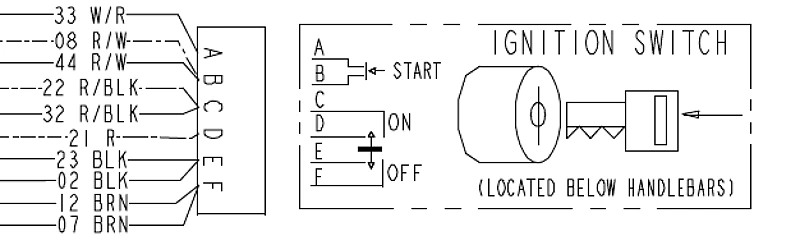

If that checks out and you fear the issue lies within those wires you describe, here is a look at the wiring schematic for the Trailblazer 250 (we don’t know which year yours is). The color coding should get you in the right direction.
Polaris Trailblazer 250 Ignition Switch Wiring Diagram
Polaris Trailblazer 250 wiring schematic
