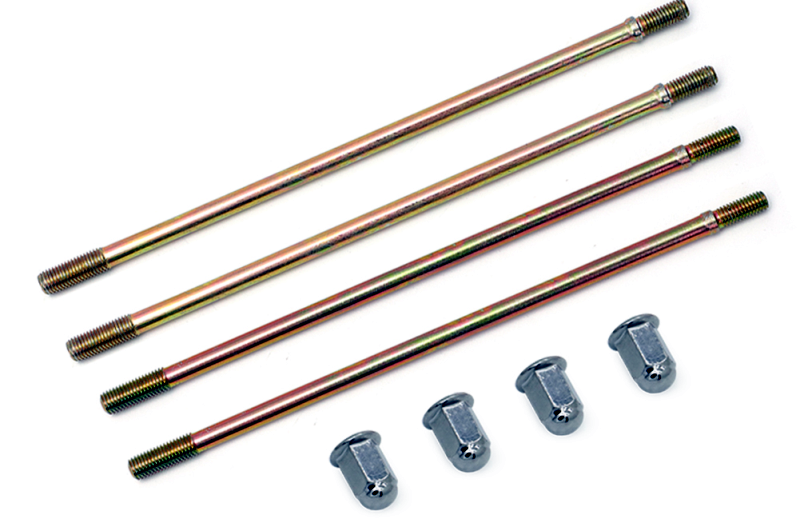

Dear ATVC: I have a Venom Madix 110 ATV that is leaking oil at the junction of the cylinder and cylinder head. I assume that it is a leaking head gasket? Can I re-torque the bolts on the cylinder head to possibly stop the leak? I have attached photos of each side of the engine cylinder. There are four acorn nuts on top of the cylinder head and a hex bolt on the left side of the cylinder head. Which of these bolts or nuts should I tighten and to what torque?
This is actually several questions so let us break them down. It is possible that tightening the cylinder bolts will solve all of your issues in one fell swoop, assuming of course that the only reason it is leaking in the first place is that these bolts have loosened up due to vibration.
Venom 110cc ATV Cylinder torque spec
If, on the other hand, you overheated the engine to the point of cylinder warping, you would also experience a gap at the head gasket junction that wouldn’t be fixable simply by tightening up the bolts. Additionally, and especially on off-brand machines, sometimes the head gasket itself simply deteriorates away over time. Again, if this is the case, a new head gasket would be the correct fix before simply getting the bolts tightened up to the proper spec.
You are, however, correct, in the fabled tradition of KISS (Keep It Simple, Stupid) by eliminating the simplest culprit first and crossing more complicated bridges only when you come to them. Get a decent torque wrench and begin to tighten up the cylinder bolts to the following specifications and see if that solves your problem. Off-brand ATVs make it very difficult to find reliable spec numbers but the following chart should get you in the ballpark:
