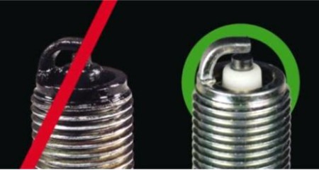

If your air intake system all checks out, time to investigate spark. Is the plug old? Sometimes it’s as simple as replacing a fouled out plug with a new one.
