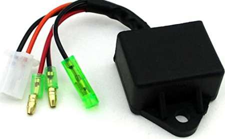

Where your question gets a little fuzzy is that it’s not clear how thorough of a swap you performed. Are you attempting to use the 2009 cam inside the 2014 engine? If you brought over the 2014 engine and transmission wholesale, the problem most certainly is one of ignition incompatibility with the 2009 electronics.
We’re going to assume the latter is the situation, in which case the best course of action would be to run the CDI box, voltage regulator and ignition coil from the 2014 model. It doesn’t sound like a cam issue to us so much as an ignition one. Especially given that you’re playing mix ‘n match.
