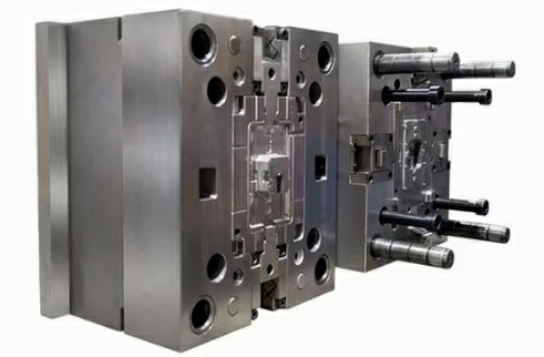

The answer is one of construction method at the factory. While the end result looks like a simple, single piece of plastic, the way this achieved may surprise you. Factories use some seriously powerful injection molds to create our machines’ plastics – the type of molds that require a massive crane just to put them in place.
Small granules of (usually) polypropylene (PP) are sucked in through a hose, heated until melted, then compressed by the mold into the final shape. When we say it takes a great deal of pressure, we’re talking to the tune of nearly 35 hundred tons’ worth.
