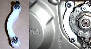

Guard
If you’re looking for slightly beefier protection for a bit less coin, click here to check out one of the many aftermarket chain guard offerings available for the LT230 (# 34).
In either case the entire assembly is a simple bolt-on affair and will get your son in the saddle a few moments after it arrives.
