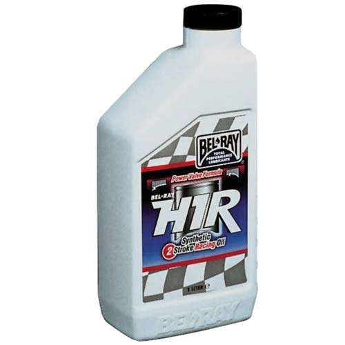

The reason you’re seeing such a swing in recommended premix ratios is that the correct number has a lot to do with the brand and type of 2-cycle oil you’re using.
For a long time, the standard for performance 2-strokes was 32:1 but then synthetics came on the scene and that number dropped to 50:1.
The owner’s manual to your quad said 20:1 was adequate but do keep in mind we’ve made a lot of strides in the quality and protection of oil molecules since the late 80s/ early 90s.
The best way to tell, honestly, is to see what the manufacturer recommends on the bottle of the oil you pick up. Brands like Bel-Ray, Maxima, Klotz and so on typically recommend 40:1.
