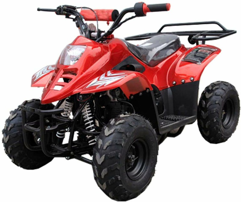

Everything checks out except for that ATM on the vehicle identification. These days Tao Tao uses ATM to identify their street legal scooter line while ATA represents the ATVs. This is where a picture of the machine in question could have been very helpful. Were we to guess without seeing it, it could refer to the ATA150G. If it looks like the above photograph, that’s the 2007 110. If it looks like the machine below, that’s the ATA150:
