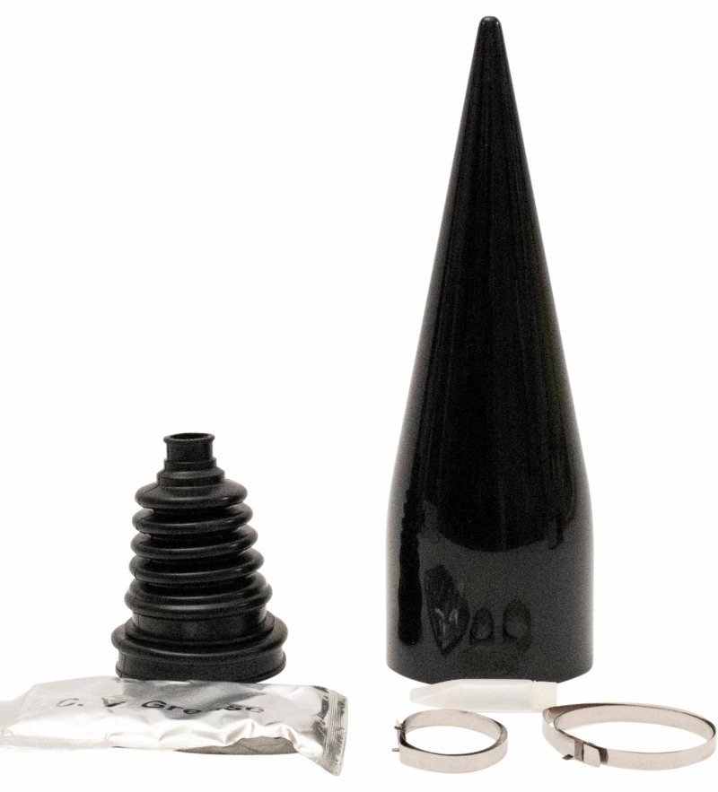

Your best option, though, is to probably pick up an All Balls CV Boot Kit – No. 19-5036 that goes for $38. This plastic cone allows you to properly rebuild your CV boot without having to disassemble the axle.
ATV/ SxS trail side CV boot repair kit
Almost like slipping on a sock, you slide the cone right over the large side of the joint then stretch the rubber boot right over the cone. Push it down onto place and use the included band clamps to tighten it up once in place.
The kit includes everything you need (cone, boot, clamps and fresh grease) but you need to provide your own band clamp tool. We grabbed one from Home Depot for $20 and consider the entire investment a very affordable insurance policy.
