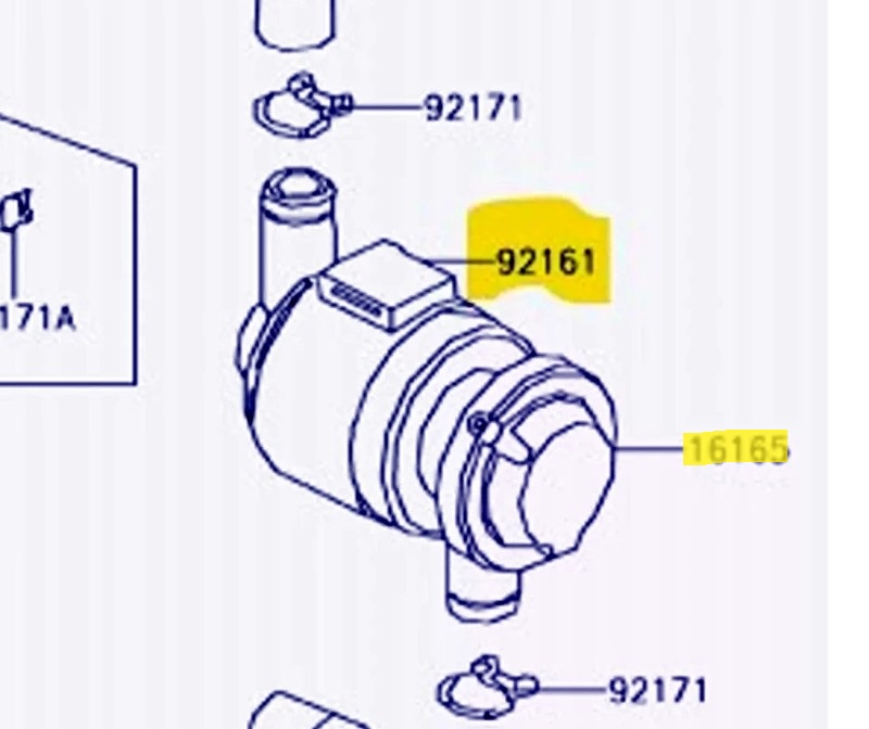

Dear ATVC: I have a 2022 Kawasaki Brute Force 300 equipped with a vacuum air switch valve separator. Does anyone know what this does and if it would cause the ATV to die if that part is bad or going bad?

The entire assembly consists of two parts – we’re enclosing the diagram with the OEM part numbers for you below. And searching salvage yards, eBay and the like does turn up several used units if spending OEM cash is a bit out of your budget.
