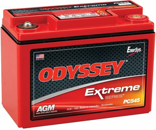

Honda 400EX winch battery
We can only answer with an “if” there – as you may find it simply lacks the amp draw capacity to function. The danger here is even if it does seem to be working, you could be severely diminishing the life of your battery without realizing it. Keeping all of this in mind, you may want to consider devising a mount for a dedicated battery for the winch based on its recommended power specification. Then just keep it topped off with a trickle charger when the ATV is parked.
