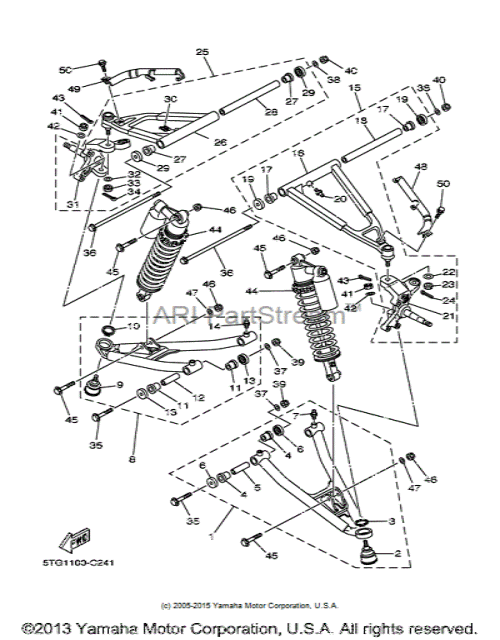

Assembly
Most riders consider extended A-arms to be a useful modification, adding to the stability of the machine without sacrificing suspension travel but if you are positive reverting to stock is the way to go for you, you can purchase OEM A-arms from any official Yamaha parts supplier like this one. Unfortunately, these assemblies from the factory are not cheap. Expect to pay around $250 for each of the upper A-arm assemblies and $207 for each bottom. If you take a look at the above schematic, it becomes clear that the actual A-arm assemblies are but a small fraction of the parts that make up the stock front end.
