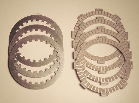

2009_ATVTech_Clutch_PlatesThe core of any clutch is the tolerance within the friction plates. It’s these fiber and metal rings that take a majority of the abuse in sloppy shifting and the wear and tear associated with normal use. Perhaps intimidating to the untrained eye, the reality of the situation is that the stack of plates within the clutch basket is usually quite easy to access and just as easy to assess by simply looking carefully.

Once the springs and pressure plate are off, the fiber clutch plates should finally be into view. Inspect these plates carefully for uneven wear. A strong clutch should have ample fiber material present on the plates (or at the very least, some visible meat on the friction squares that line the fiber pads). Normal color should be shades of brown to beige. If the plates are black, singed, burnt or damaged, replacement is your only option.
Now you’ll likely notice that nestled between each fiber clutch plate is a metal (steel) plate. These plates are actually even easier to diagnose thanks to factory-installed dimples designed to indicate wear. If these patterned dimples are flattening out (becoming smooth) or there is visible warping of the plate itself, toss them aside as well.

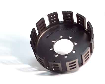

2009_ATVConnection/Tech_Clutch_BasketOnce you’ve assessed the condition of all of the metal and fiber clutch plates, take a look at the clutch basket itself. The basket is notched with ears (sometimes called fingers) that grab hold of the sprocket-like extensions of the fiber plates. Carefully inspect these ears for grooves where the plates make contact. If there are markings on the basket here, it’s likely your clutch has been getting steadily more difficult to engage at the lever.
If everything mentioned above checks your visual inspection, reassemble in the reverse order. The best method of repair should one or more than one of the areas fail to check out is to purchase a complete clutch rebuild kit which most certainly will include a new basket, springs, fiber and metal clutch plates (hang on to your stock bolts just in case). And of course, each individual component is sold separately should a total rebuild prove unnecessary.
