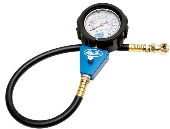

1) Check Your Pressure Regularly
Press
Sounds obvious, right? Well the leading cause for trail-going pinch flats is running too little air in the tire. Further making this one tricky is the fact that as ATV tires get softer than the recommended PSI, they may even gain valuable traction on the process. The downside of course is all it takes is flat landing or good smack into a rock or root to pull an under-inflated tire’s bead clean of the rim. This is one of those lessons you never want to learn miles from civilization.
