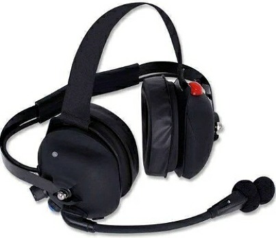

We would recommend swinging by Rugged Radios. These guys literally specialize in exactly what you’re looking for. They offer a whole variety of wearable and mountable long-range communication options, all of which are specifically designed to take the pounding of off-roading.
The only downside is the ATV category is going to yield mostly wearable units for the reasons you describe as far as a lack of viable mounting options is concerned. However, with a little ingenuity, mounting one of their UTV/ SxS models to a quad is by no means impossible, especially if your ATV has racks. If it doesn’t, your only real option would be to devise a plate that would attach to the rear grab bar of a sport quad.
