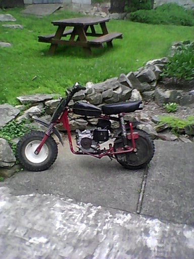

I tell ya I just put a harbor freight 212cc in my Manco it is now a wheelie machine just stopping isn't really gonna happen
Attached Thumbnails 90cc Manco- new piston/rings/carb- won't stay running-photo-0046.jpg
