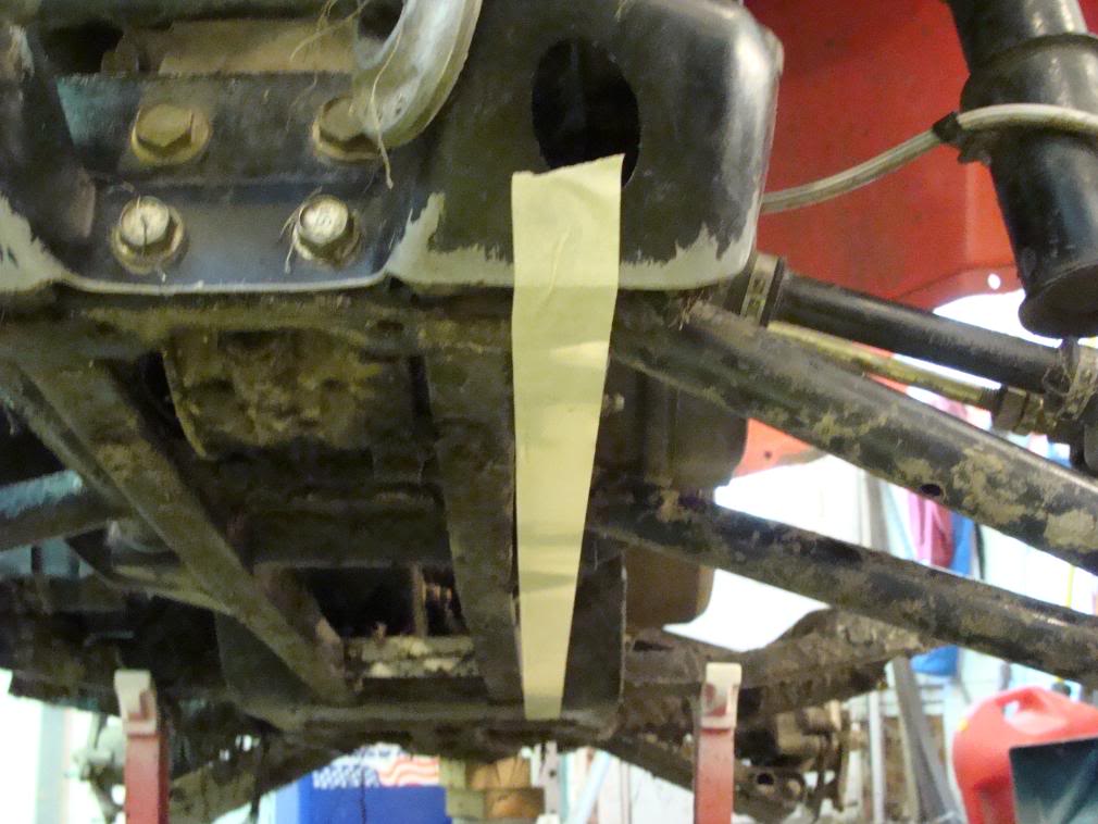

Decided to take a stab at Straightening the frame myself, (to stuburn to take it to a frame shop!), started working on it and didn't think to take a picture till after my initial setup with the Porti-Power so some of the frame bend has been removed at this point, (measured 5/16" initially).

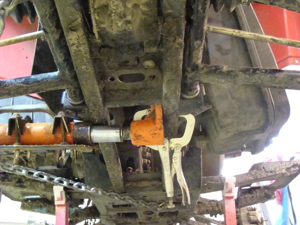

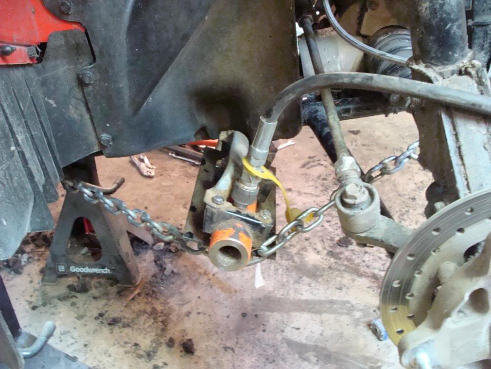

These are a couple pictures of the Porti-power setup...and yes, I was at a safe distance!

This ended up working quite well and the frame is once again nice and straight. I will be adding a steel plate welded between the frame rails to strengthen this area!

Thanks, good pics and rememdy. Now to figure out what caused it.
Any chance it did a nose dive on the LF wheel?

Looks like you did a great job at fixing it. See stubborness pays off occassionally.

somewhat surprised that this little scheme actually worked as good as it did! Now to get it reinforced so we can get back out on the trails and not have it in the back of my mind all the time!

That set up sure looks like it should of had a plate from the start,that way it has to bend both rails at the same time for a bend to occur which is much tougher.
