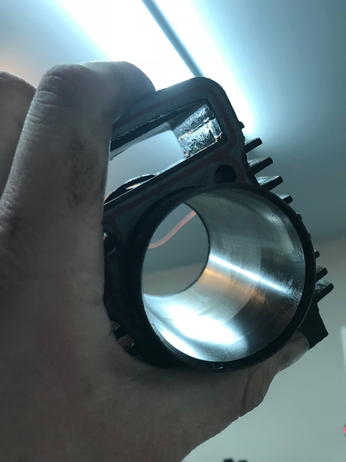

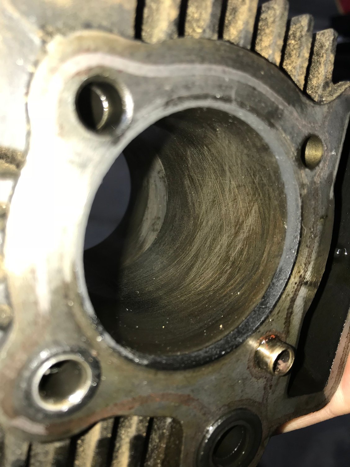

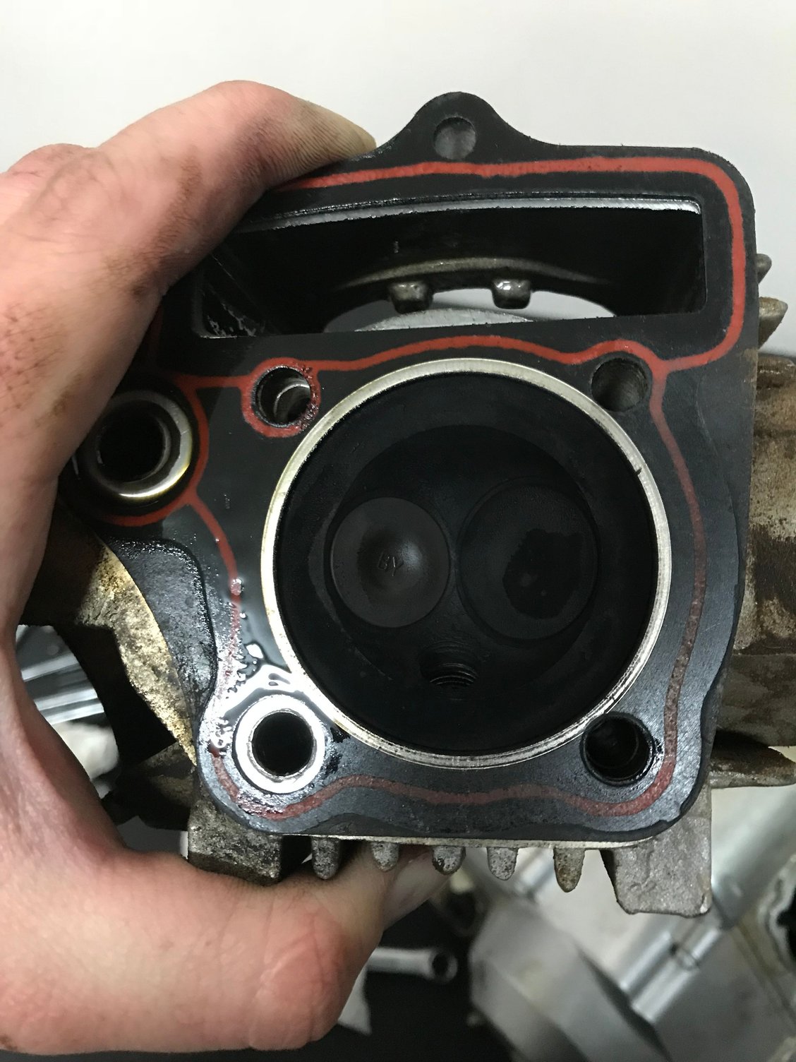

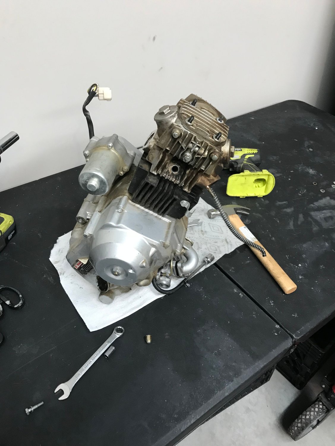

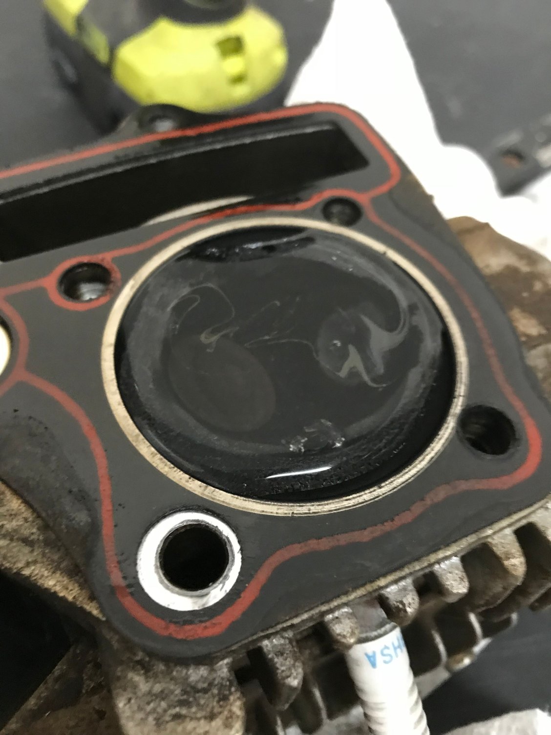

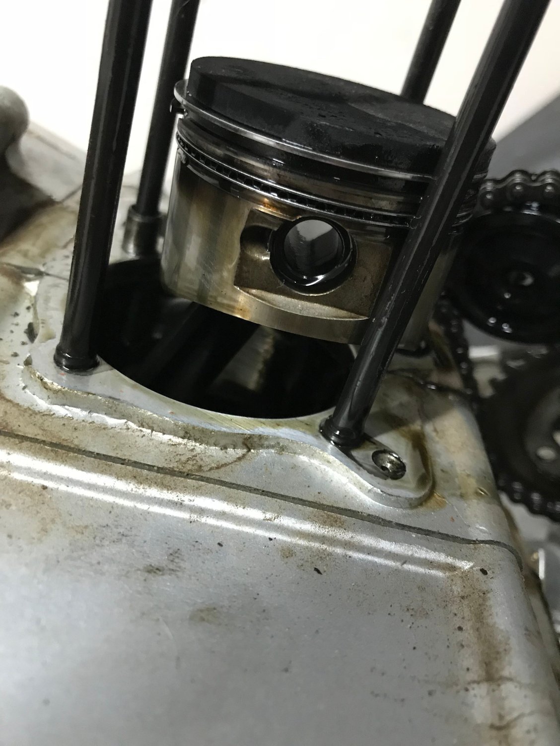

Well I took it apart. Rings/piston and bore looks good. The valves closed holds water. I’m honestly stumped with this thing...the thing is a slug.

Did you check the ring gaps. Take the top one off and put it in the bore, measure the gap with feelers, should be under about 0.012" Make sure you know which way up it is, as it has to go back on the piston the same way, if it is OK. Check the valves are seating properly, (I would use fuel rather than water, far more searching), and that the clearance is correct 0.002" to 0.003"

I could be wrong but compression should be over 100 and anything under that is calling for a rebuild..

Anything under 90psi is suspect, but as the bore is OK it can only be rings, valves or head gasket. Some of those engines have automatic de-compressors too, so you can't take the readings too literally.
