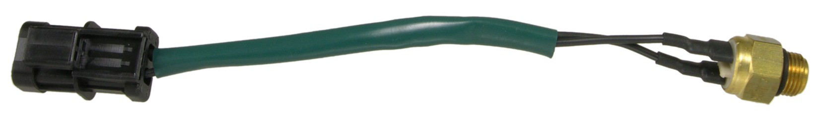

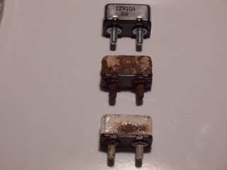

If the fan is intermittent,check the fan circuit breaker in the plastic pouch under the front panel for corrosion. You can split the pouch open,replace the breaker if needed from any auto supply. If the radiator sensor is the problem(usually they short out and fans won't come on) you can replace these with a Wells Sw526 also from any auto supply. Just use you oem connector end.

Thanks Polaris Tech. There was a lot of dust and corrosion in that harness for the switch. So I am going to clean it up. I bypassed the switch and the fan motor was going like a bat out of hell. So the circuit breaker is good. My plan is to hit up the O'Reillys and get some wire, a fuse, and a switch. I will reconnect the rad switch, and if it over heats I will just set up a manual switch. I'm not paying $66 for a new rad switch.

Don't hook up a fan manually as you may end up letting it get too hot. You can get the Wells sensor for less than 25 bucks that will do the same thing as the oem.Duralast/Cooling Fan Switch - Radiator SW526- ReadReviews onDuralast #SW526

You don't have to flush the radiator.. Just have the new sensor ready,unplug and unscrew the old one and quickly install the new one and hook it up. Leave the radiator cap off, let the fan cycle on and off to remove any possible trapped air pockets,top off the radiator,replace the cap. Job done..
