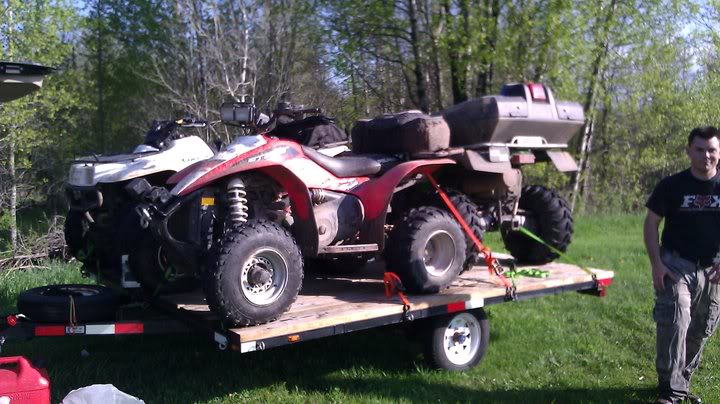

Have you looked into a snowmobile trailer? That seems to be what most everyone uses around here.
Here's my trailer, it's an 8x10 flatbed. Very similar to a snowmobile trailer. Does a great job of hauling 3 quads. That's my Scrambler and the wife's Kawasaki side by side and a buddy's Arctic Cat 500 on the back.

Another thing to watch is the tires, they are many times the weakest link in the whole trailer. My trailer has 12" wheels. When I got it, it had 5.30-12 bias ply tires on it that were rated for something like 900 lbs each. I'm sure these tires were overloaded and they got pretty hot when towing with just 2 quads on the trailer. I found some ST145R12 radial tires that are rated for 1500 lbs each. Even though these tires are actually smaller and spin faster, they barely get warm even with 3 quads on the trailer.
