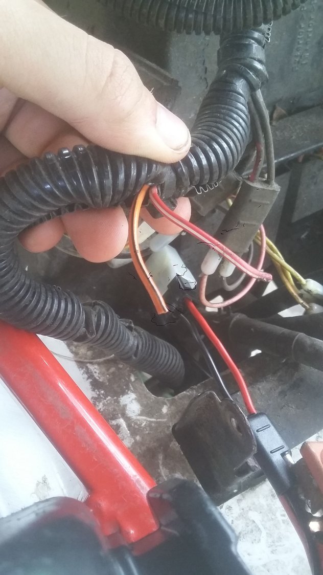

Can anybody help me find the right wires to hook up my fan? Im thinking these are the wires but im not really sure. Somebody must know!

I just have the 330 manual ,but the wires should be a red/white and orange/black. Just trace the wires down to the fan motor to make sure. 325 and 330s hardly ever had fans kick on as the oil cooler thermistor sent the signal to the thermistor module to kick the fan on at 260 degrees.Had to get really hot for the fan to kick on.The thermistor sensor and modules were problems on both machines and failed a lot.If you really want the fan you can have it on a toggle switch. Otherwise the fan is really not needed on this oil cooled atv as most other oil cooled brands didn't have fans to begin with.
