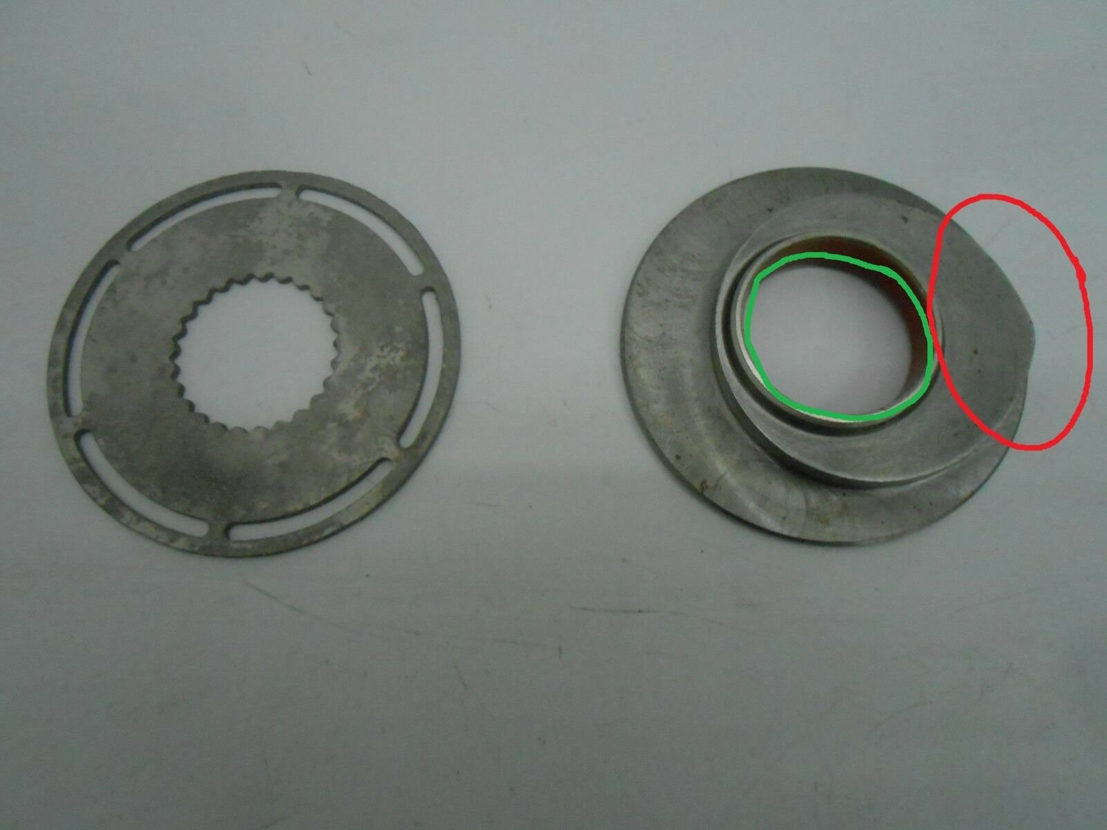

ADC can be eliminated in more than one way. Electrically you can remove the Brown/white and grey/red wires at the connector. On your machine Im not recommending this fix because there is a serial number break, which that year has 2 different "ADC" switch assemblies on the handle bar. It works on one style but not the other. Basically it can be done this way on some, but not all. Others years and models MAY have different color wiring too(in case anyone with a different model reads this)
Another thing you can do since the gear case is apart already is with this part - 3234434 Kit, Cam and Armature - Either grind the "CAM" in red, off so it wont actuate the ADC "Pump" or you could probably just remove it to and leave just the inner "race" in green, but the spacing I believe is important for clearances(been a while since I did it) Also, since its apart, dont bleed the ADC system and that wont allow it to function either but will still have oil in for lubrication.
