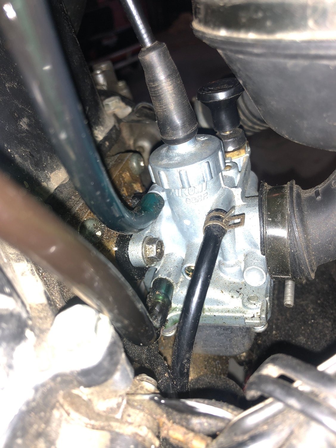

Hello!
I just recently purchased an 01 LT80. Iíve noticed that it doesnít seem to really have much for top end. As you ride the bike it seems that from a stand still the bike takes off great. Then as you get into the top end of RPM, it seems to sputter and feels like it hits a ďrev limiterĒ in some sort. Iíve read about the carb being restricted. Thereís no brass ring. Iíve also read about there being a ďwasherĒ in the exhaust. I removed the exhaust and didnít really see anything that would point to there being a washer inside the exhaust. I was told it has recently had a top end done by a reputable bike shop close to me. Any help would be GREATLY appreciated! Thanks!!

I forgot to add. The guy I had bought it from said that there was a brand new carb installed on the bike. I can pull it off and clean it out anyways. And the other thing is there any way to tell if the exhaust is blocked off? When you start it you can feel good amount of flow through the exhaust

A new carb doesn't mean something didn't get in. Example: the tube on the right, that's the carb vent. I see it's pointing down. It is supposed to be run up under the hood. I don't know where it is going now, but that may well have how got dirt in. Also, in the pic you can see that the rubber piece/clamp that connects to the carb isn't 100% in the correct position.
Curious, have you done clutch maintenance?
