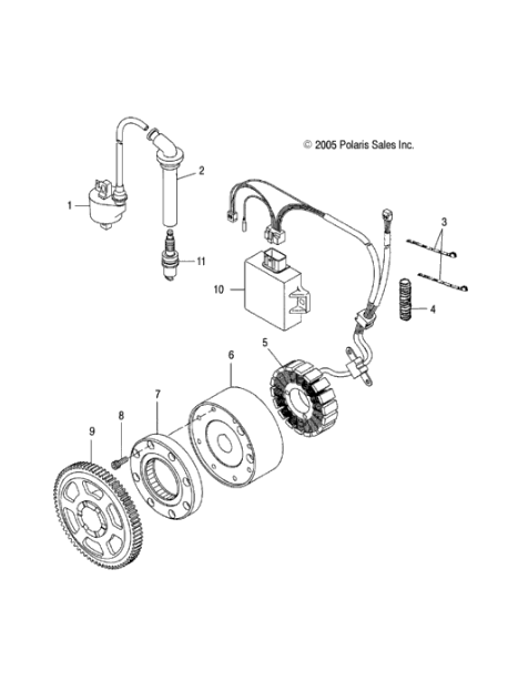

Then the problem could be in the starter clutch. The manual should show you step by step on how to replace it.Item#7.
