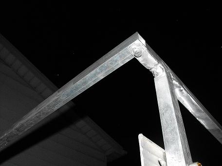

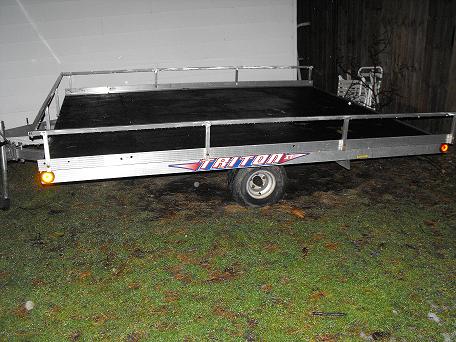

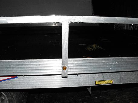

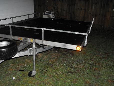

I ended up making my own. I located 40' worth of 1"x 1"x3/16 wall square tube aluminum at a local welding shop for $105 which was super cheap compared to some places I looked. A little time on the side at work with a mig and I ended up with a set of rails that look very close to what Triton sells but I have a feeling mine are much much stronger. I can ratchet strap the sportsman down using the rails so tightly that the suspension squats quite a bit and the rails barely flex. I had the welding shop cut me 4- 10' sections. The side rails ended up being 10' in length and 10" tall from the top of the deck and the front rail is 101" wide and 10" tall. In total I had about $120 in materials and hardware not to mention I fabbed everything at work on the clock and the boss was ok with it! Sorry the pic's are in the dark.

That looks really good...I've always wanted to do something like that on mine just never got around to it...One question, with the extra weight added weight, does it stay tilted on it's own? I know on some angles mine doesn't wanna stay tilted on it's own unless I put a little weight on one of the back corners...I was wondering how those small gas shocks work in holding it tilted...
