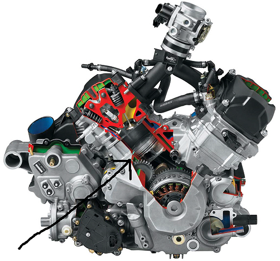

Dear ATVC: I’ve got a YFZ450R and I’m a little paranoid about top-end maintenance and don’t want to blow up my engine. I ride pretty hard and race the open class on weekends. Is there any way to tell if my top end (rings specifically) are wearing or worn down without actually tearing into the engine?
Actually, yes, there are signs to watch for that can clue you in on the condition of your rings without digging into the internals and all of them involve oil.
First, keep an eye on your muffler. If you’re noticing abnormal amounts of exhaust smoke or blow-by oil splatter accumulation, that is a pretty good indicator that you may be due for a top end refresher.
Next check out the oil breather tube; moisture is normal but if the tube is dripping oil, this is also a sign that excessive ring wear is allowing oil to freely bypass the piston.
Finally, and it probably sounds obvious given the other two answers, be aware of oil consumption. Watch your sight-glass very carefully; if you discover you’re frequently having to add engine oil to maintain the normal operating range, this is a strong indicator that the top-end is worn.
