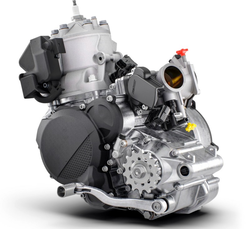

Based on what you asked, a very good transplant candidate would be the KTM300SX. It should fit fairly well physically, offers a counterbalancer to smooth things out and has electric start to boot.

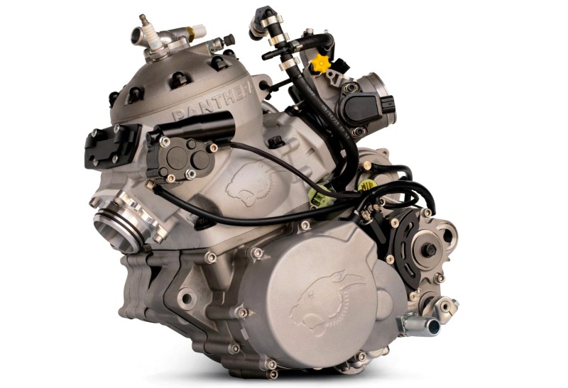

However, were it our build, we would probably forego the idea of trying to mate a motorcycle 2-stroke and just buy a brand new 600cc fuel injected 2-stroke mill from Panthera. The only downside here is those aren’t cheap. Depending on the configuration, it can cost between $6,800 to $9,800.
