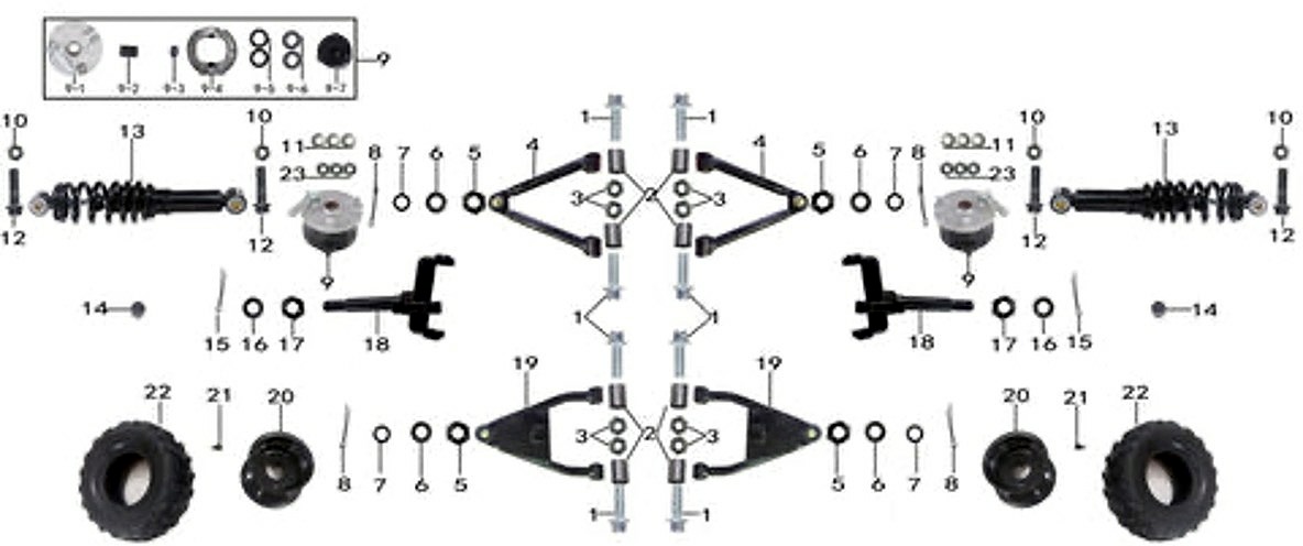

Dear ATVC: I am having trouble finding replacement left front wheel hub studs for a TaoTao Rhino 250cc ATV. Cannot seem to reach VMC for parts replacement and need other sources. These 4 studs are full thread with torx type drive 7 with compatible flanged nuts.
Your help would be appreciated, Richard.

Based on what you describe and the schematics we’ve studied, our best guess for what you need is part # 105013 – Hex Flange Bolt M10x1.25×50 (#12 on the above schematic).
If that’s not correct, and what you need are the studs that pass directly through the spindle and fasten via lug nuts, you may have to purchase a new brake hub assembly which includes the wheel studs integrated already. That would be part # 112341 – Drum Brake Hub for 10″ rim.
