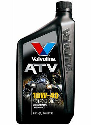

If the oil level is up there- changing it to fresh will usually help a great deal. Old, broken down oil will also make shifting much more stubborn. Lastly if it’s been recently changed, pick up ATV specific oil and switch to that. You will recognize it because it will say “specifically formulated for wet clutches” – which is what you have here. It will contain additives that keep clutch slipping to a minimum unlike regular 4-stroke oil of the same weight.
