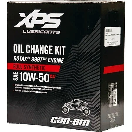

Fluids
SxS / UTV Maintenance Tips
An engine’s fluids are absolutely vital and a key maintenance point. Check your oil often – not only for correct volume but also for clarity/ color and for presence of debris. The factory recommended intervals are usually pretty accurate but don’t be afraid to change your oil earlier if it’s abnormally black, thin or contains traces of metal mentioned above. And never perform an oil change without a fresh filter.
Check that coolant at least once a year as well.
