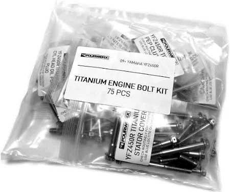

We’re going to have to assume you are talking about a fender bolt kit as going for the really big stuff in titanium is very, very expensive but of course, that’s where the biggest strength is gained and weight shaved. For example, a titanium swingarm pivot bolt alone can cost nearly $500. Same for an engine bolt set like this one:
