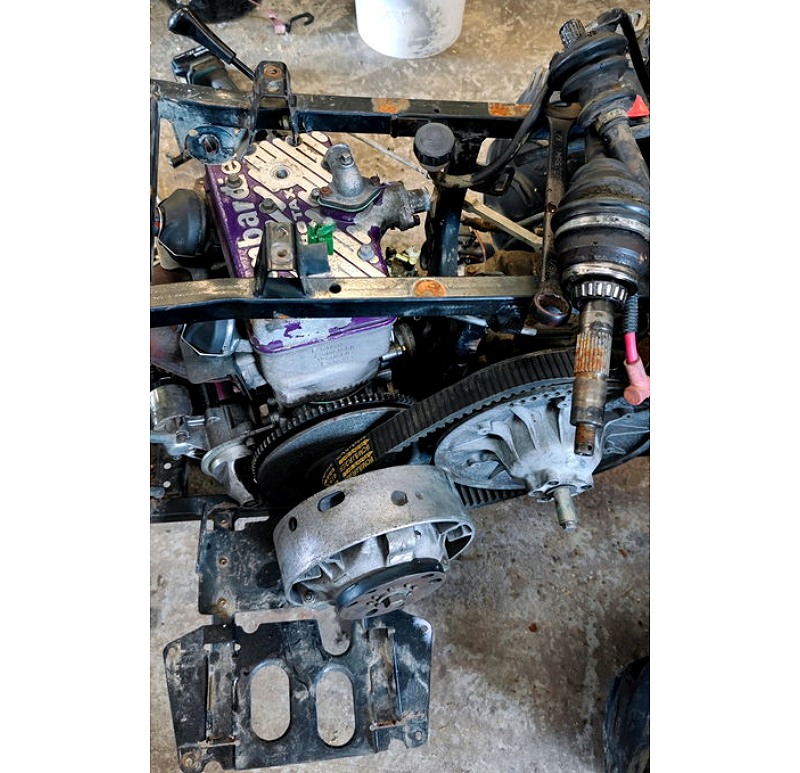

Dear ATVC: I am swapping a 670 Rotax snowmobile engine in my Sportsman frame and need a longer belt to fit the carbs. Where can I find one?
An important aspect missing from your question is how long does the belt you need have to be? Even if you don’t have an exact specification, measuring the distance between the pulleys in question should give you a decent estimate.
Drive belts come in MANY various lengths. Why? Because they are used in everything from automatic ATVs to snowmobiles to golf carts to many street going motorcycles.
As a result, they can be found even in many auto parts stores.
Ask The Editors - Mystery Belt Mystery
We deal with Off Road Belts LLC (ORB) – who have a wide variety of lengths in stock like this 35-inch.
Check out their assortment when you have a better idea of the length you need and don’t hesitate to contact belt manufacturer D&D directly if you end up needing something that has to be cut to a custom length.
