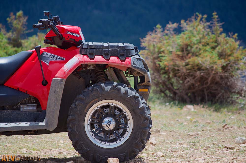

After a call to ITP, followed by some shameless begging, ITP sent us a set of 27x9R-14 and 27x11R-14 Black Water Evolutions on SS216 ITP wheels. We literally counted the days until they arrived. We love testing tires though I can’t say exactly why, and from the moment the Black Water Evolutions arrived we knew these tires were going to be a great all-terrain. We were headed off to Taylor Park, CO two days after they arrived, which offered an opportunity to put many miles on them in a matter of a few days over terrain perfect for testing tires. Taylor Park, CO is extremely rocky in places, making for a rough ride with plenty of opportunities to puncture a tire. Taylor Park also has a little mud, lots of water crossings with smooth rocks, and several places with serious hill climbs on loose soil. Taylor Park might be the “perfect storm” for testing all-terrain tires. We mounted the Black Water Evolutions on our 2012 Polaris Sportsman X2 demo, loaded it on the trailer the following day, and headed off into the sunset towards the Rocky Mountains.

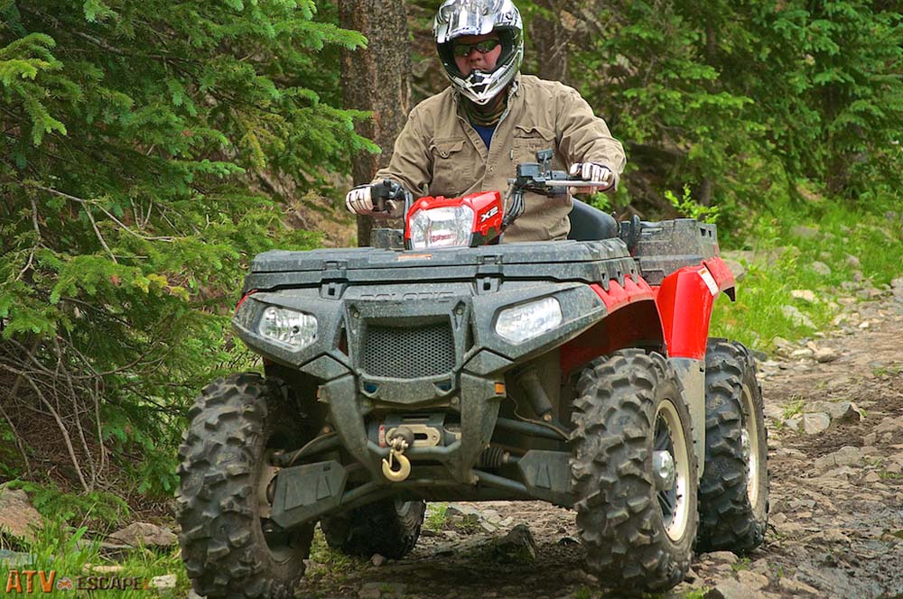

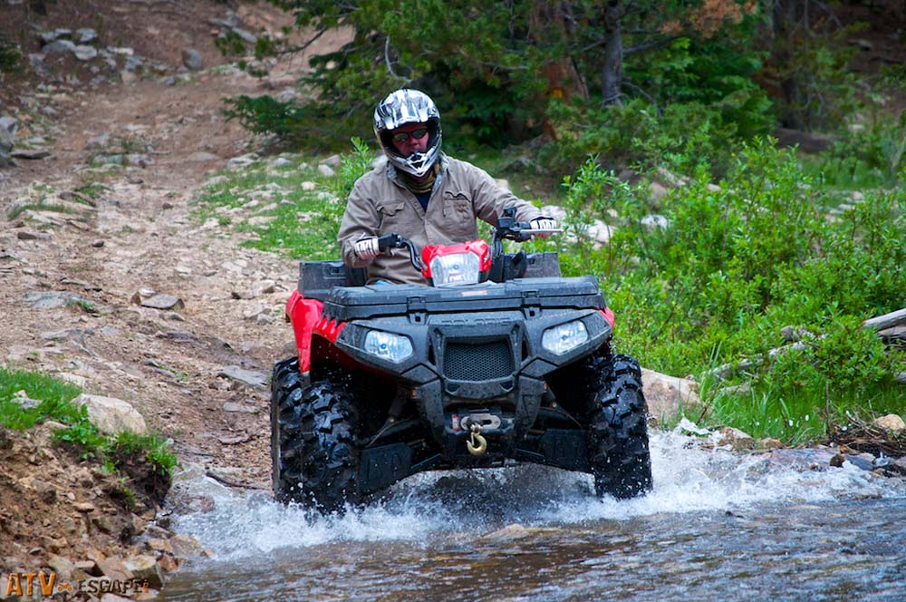

Traction

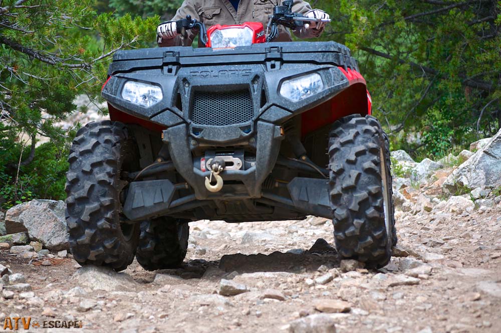

The Black Water Evolution is truly one of the best all-terrain tires we have ever tested on an ATV (and soon we will test them on a UTV). They perform exceptionally well on a variety of terrain from hard-pack trail, rocks, loose dirt, sand, and the added bonus of mud and snow though not specifically designed for that terrain. We tested the Black Water Evolutions on our Polaris Sportsman X2 550 right alongside a Polaris Sportsman Touring 550 with the original tires, making the only real differences between the machines the tires and power steering. The difference in traction was staggering. The Black Water Evolutions hook-up quickly and effortlessly on rocks with no fuss. They seem to reach out and grab whatever you take them over. A little gas and off you go. The tread pattern is nothing exactly like we have seen, but it looks good and better yet it works very well. Generally speaking, all-terrains should work well over most terrain even snow and mud. We have found in our experience most all-terrain tires do well on the trail and do “ok” in mud and snow. There seem to be some tire manufacturers making tires now that do great on most terrain and pretty darn well in mud and snow. ITP and the Black Water Evolutions fall into this latter category. On many of our adventures with all-terrains, we avoid any serious mud or snow, since we want to get back to camp without being knee deep in mud. The Black Water Evolutions allow us not to really worry about that. They are not MUD BOG TIRES, but they do exceptionally well in the mud and snow for all-terrain tires. It is nice to hit the trail and know you can tackle almost any terrain without worry. Couple this with the fact it is a tough tire, and you can have confidence you will make it back to camp without any problems.

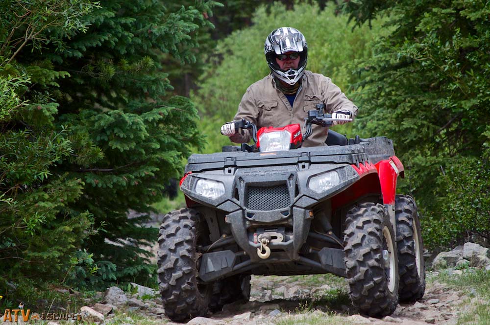

The Ride

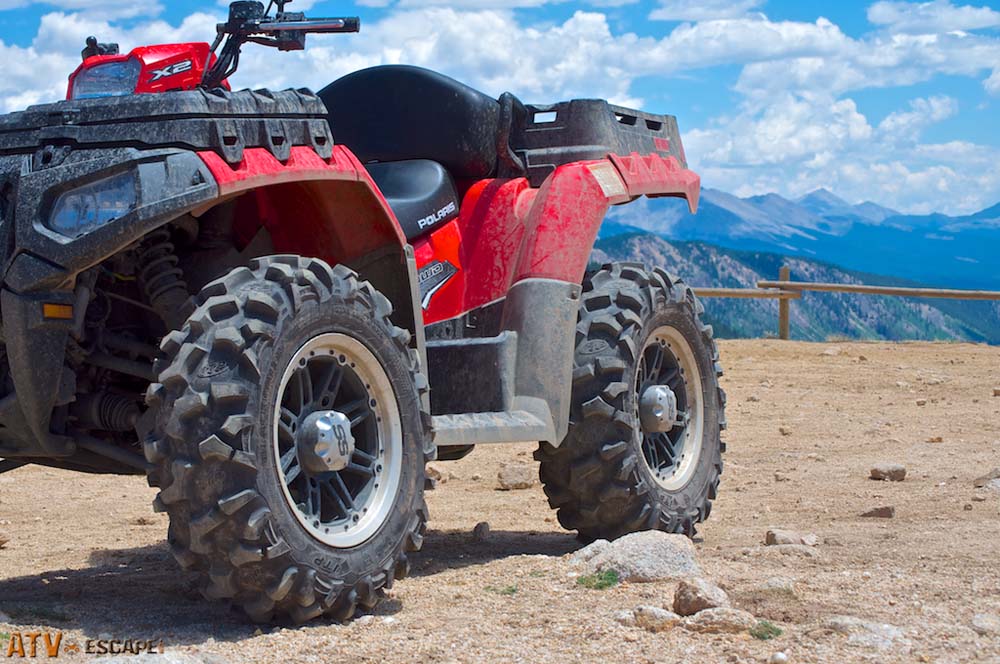

First placing the Black Water Evolution tires onto our ATV, we noticed immediately how “solid” these 8-ply radial tires are. They have almost no flex at all when you have 8 or 10 pounds of pressure in them. This was extremely noticeable on our utility ATV, and in our opinion would be much less noticeable on a UTV (we will be able to form a better opinion on this in the near future). The ride was rough, not because of the tread design, but because of a lack of flex. Though the handling down the trails was spot on, the ride was rough. So the only thing to do was to get these tires to flex! We set off to discover at what P.S.I the ride would smooth out. It turns out that 2 -2.5 pounds of pressure is where we get some flex and pooch in the sidewalls. From that point on the ride became much smoother. The Black Water Evolutions are still an 8-ply tire even at 2 pounds, but the ride is smoother over the rocks, bumps, and corners. The Black Water Evolutions corner well and predictably at higher speeds. On a UTV, the P.S.I should be increased, and being that application is what these tires are really designed for, the ride should be exactly what you would want and expect.

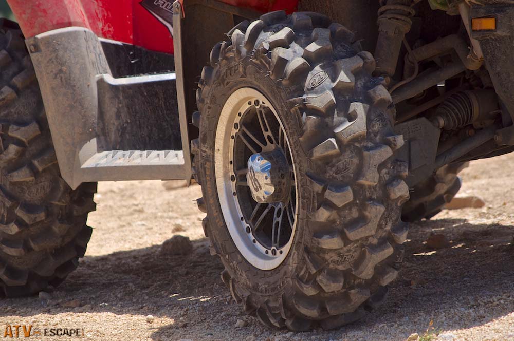

On an ATV equipped with electronic power steering, you will not notice the added weight of the Black Water Evolutions compared to stock tires, but on machines without power steering you will. There is no way around this no matter what tires you have once you get to 6 and 8-ply compared to stock tires, since most stock tires are 2 to 3-ply. Our Polaris Sportsman X2 550 didn’t have power steering, so when moving the front wheels standing still, it took some effort. Once we were moving, it was not really noticeable.

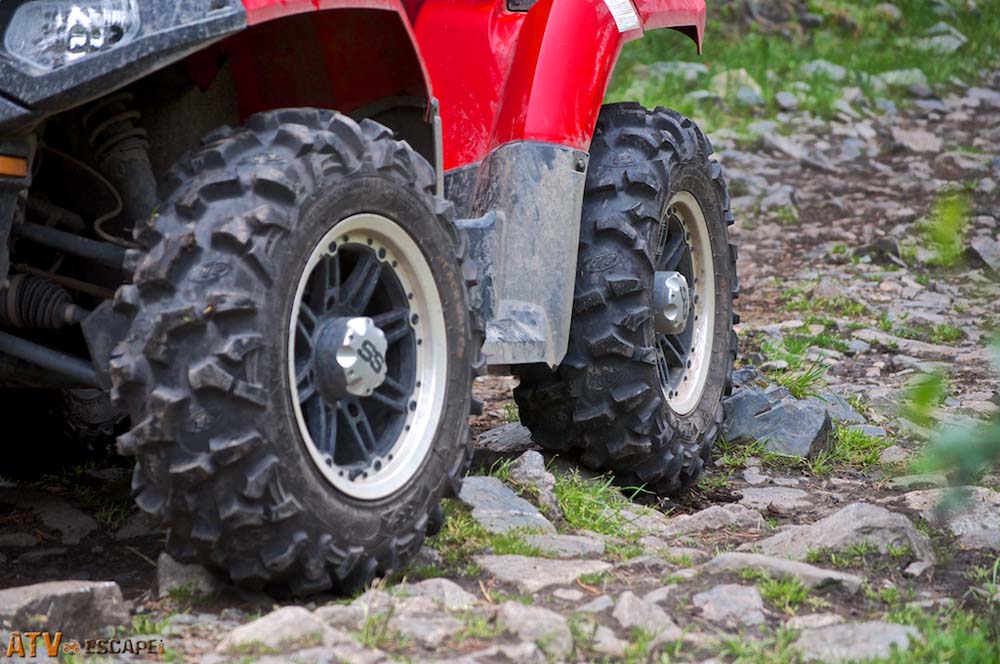

You might wonder about what we thought of the SS216 wheels. The SS216s look great, perform well, and come with a lifetime structural warranty. They come in two sizes 12×7 and 14×7, and are made of lightweight aluminum. We like the way the wheels have a machined finish with black accents in the spoke. The SS216s catch peoples’ attention, and add that custom look to your ATV.
