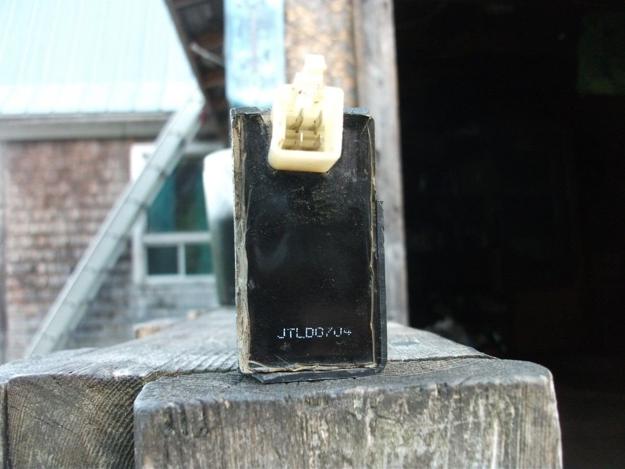

I thought this was the CDI until I started following wires today and came across the actual CDI back by the rectifier. It is a 2007 or 2008 Baja Wilderness 250 and it only has fire for a few seconds and then nothing. What is this under the left front fender? It only has wires going to 3 of the 4 pins. I don't even see anything like that listed in the parts diagram for it. Thanks in advance.

What is this? It is located under the left front fender.

This is the CDI, right?

While searching for a wiring diagram for it, I found out that it's a controller for the automatic choke.
