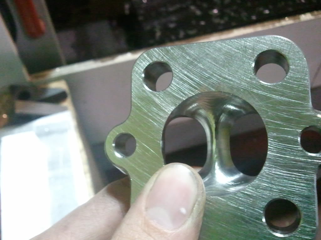

dbj216 , there have been quite a few turbos done. One guy Matt Whitbread has cnc'd exhaust flanges and done 4 or 5 installs. Several guys have a lot of miles on the turbos with no failures, to my knowledge. Stock head gaskets and head bolts seem up to the task, but I plan to research the head bolts to see if ARP might have a better one. Boost is only 10 psi or so, so it's not a radical upgrade. Everyone that has done the turbo, says that that's how it should have come from AC. Matt Whitbread said climbing in the mountains , running with his buddies in big cc gas bikes, on a hot day he could get the overheat light to come on, but just slowing down a minute or so brought the temp down. The cooling system is massive, btw. I will put a water temp gauge and maybe a pyrometer. 1 nice feature of running a turbo, makes it much quieter, maybe. haha

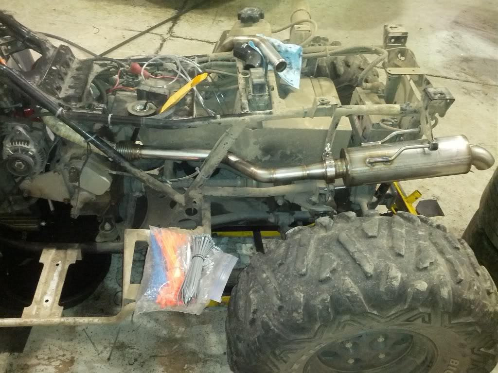

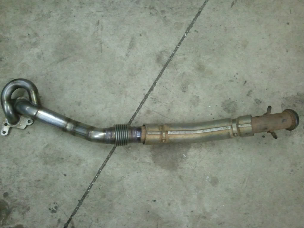

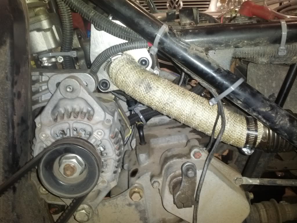

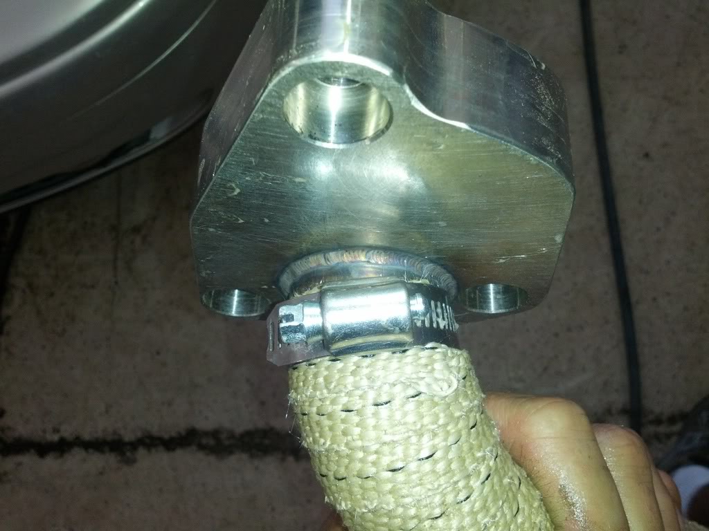

Here are pics of some of the conversion parts. He even fabricated a nice flow thru stainless steel muffler (last pic)

I notice the exhaust wrap. It looks like stock DEI fiberglass wrap. I wonder how long it has been on the machine. I'm thinking about wrapping the exhaust pipes on my Outlander, but have been advised the wrap material doesn't last in wet conditions, and may rust out the pipes.

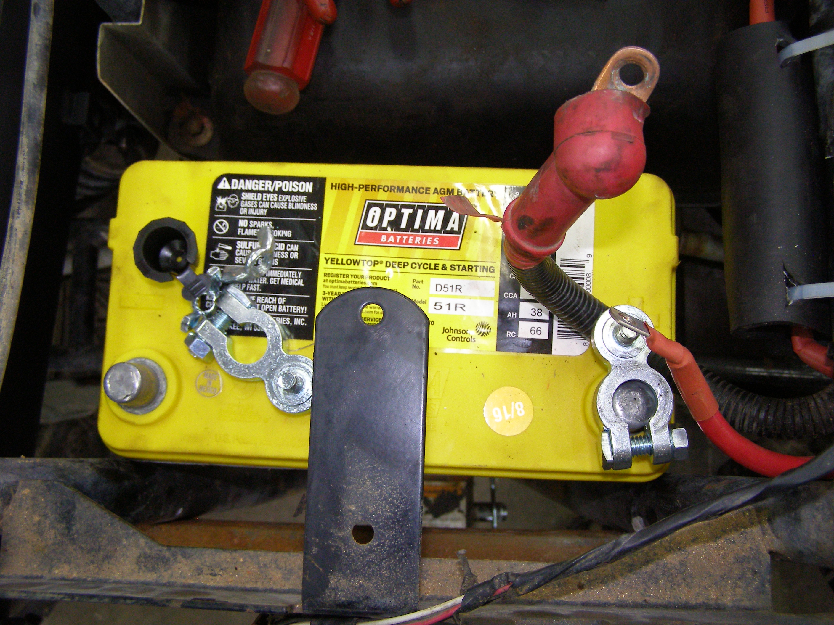

Ok, after gutting out the muffler, adding a bigger tip, advancing the injection timing, and turning the fuel to the max, nothing left, I decided that I don't need a turbo. With the 30" tires, it hits the governor at= 49.2 mph. It takes 3/4 of a mile to get there. The only fault, it's pretty loud. It's super easy on fuel, I've been about 30 miles and gauge hasn't moved off full yet. Starts at least as well as my gas ones below OF. I put in an Optima Yellow Top D51R battery (awesome) Actually room for dual batteries, but it spins over like a top at -5F . Added a 5,000 lb winch, hey, might have to haul out a stuck Jeep or 2. BTW, The exhaust sounds awesome, not unlike, dare I say it? A Harley Davidson!
