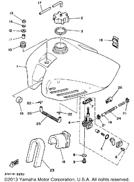

Hello. Does anyone know about these bikes I got one and the gas tank has 3 nipples where do they go?

Don't know if this helps but some of the older models used a leveling tube between tank halves and then the fuel valve.Don't know about any third nipple you're talking about unless it's the gas tank vent..

Thanks for the help it's for a leveling tube. I have never seen before. Thanks again

Old motor cycles and a lot of older atvs had this fuel tank transfer setup.
