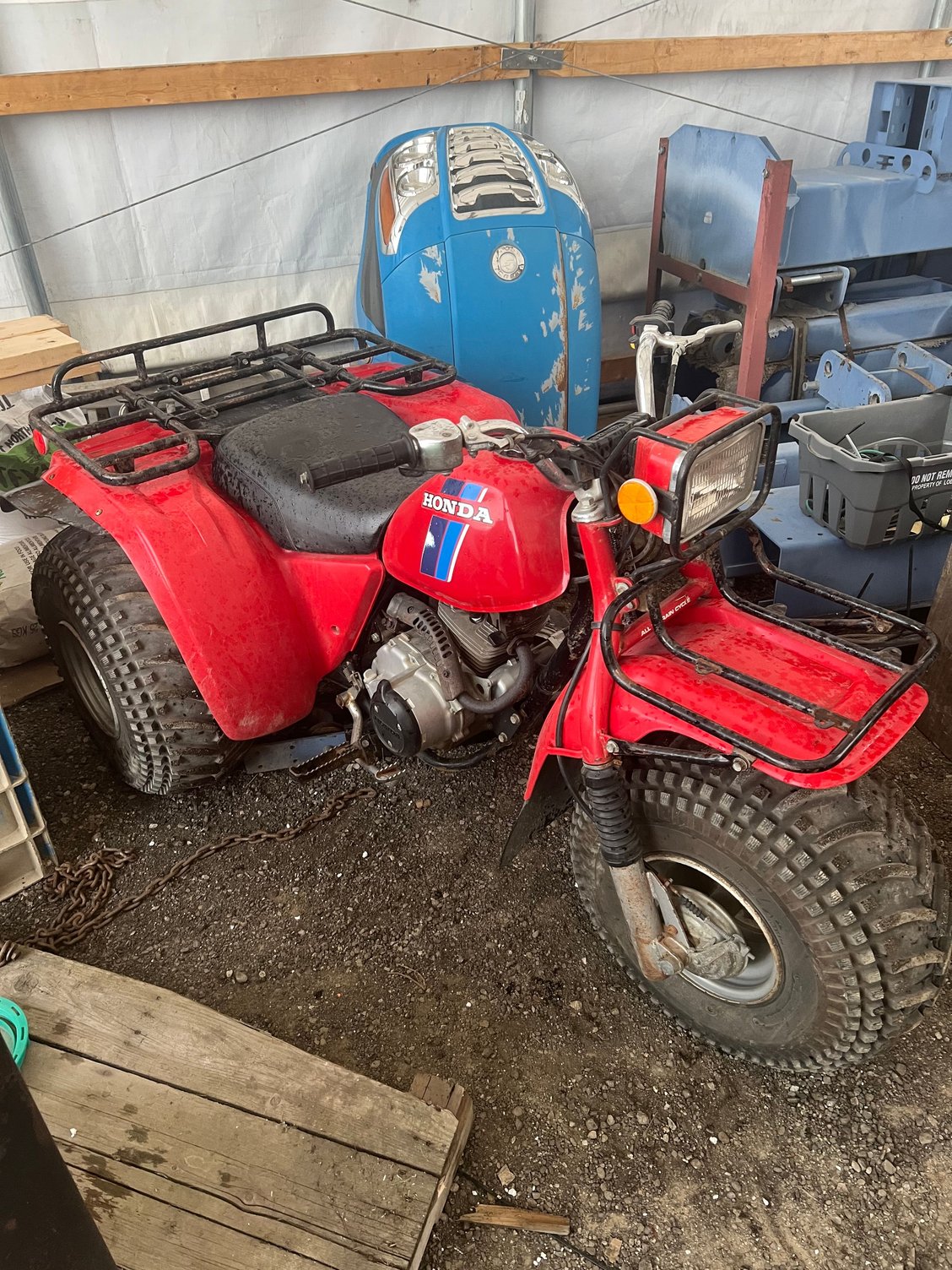

I have 1983 atc200e that I recently picked up and the electric start most of the time doesn’t work. It’s weird I’ll ride it for a bit and when I park it and go to ride again the electric start will work but most of the time it won’t the button just won’t engage anything. I took apart my button and it was all intact. Is there a ground that maybe isn’t getting a good connection or is this a sign my solenoid/relay is on its way out? Appreciate any info

By no means an electrical expert, but if it keeps going back and forth, I'd say it's definitely a loose wire. I'd check the negative wire from the switch all the way back to the ground on the battery.

Also not an expert but I would start by following the wires looking for damage or corrosion. Make sure grounds are making contact and everything is tight.
