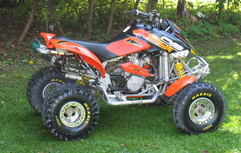

Here are a few pics after washing her up this afternoon.
Here is a pic of a new wheel and razr2
and this shows the backside reinforcing ring on the front rim, not much clearance with the caliper!

Default Sweet Tires!!!
Those rims are really nice also. Nice choice.
