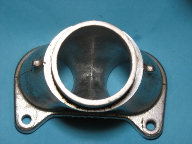

Here is the mani I just started, it is ported out to 45mm, just have to finish blend and texture the internal surfaces with Black Diamond blasting.

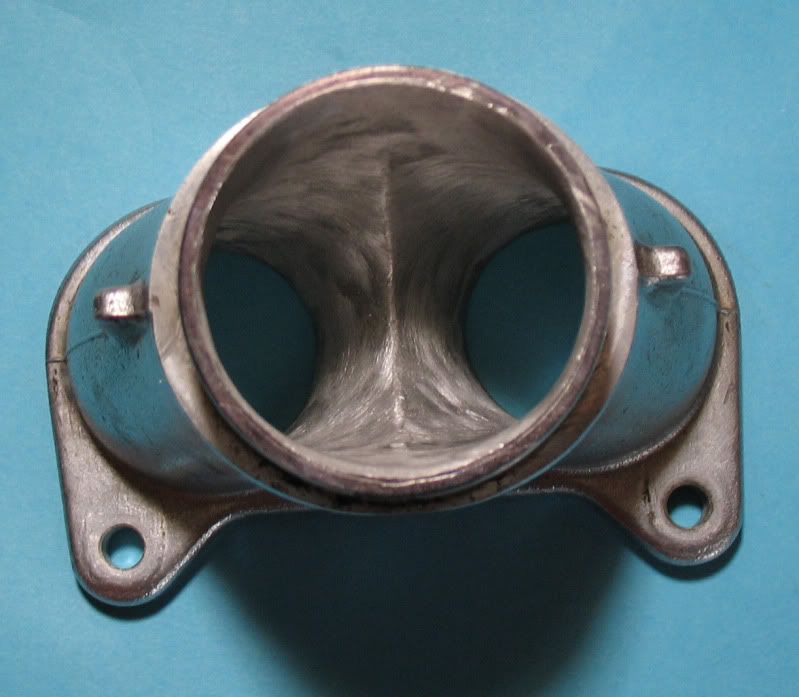

I just did this one this morning, it is roughed out to 47.5mm, final blending will take it to 48mm.
