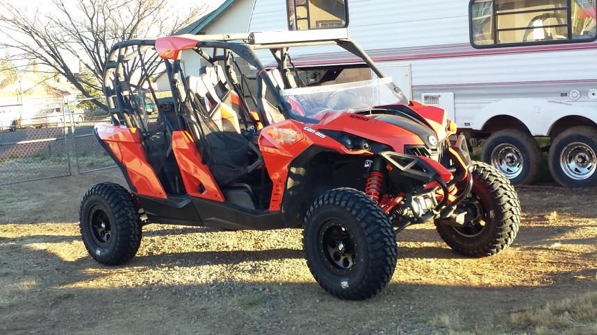

Well, i'm putting new shoes on tomorrow so I thought I'd inquire about maverick owners with 30 inch tires in general. (Not mud slinging stuff, I mean more desert oriented riding specifically)
Is the power of the machine diminished drastically?
Here's a before pic. I love this machine. I'll post an after pic tomorrow.

Which engine does it have? The 800 or the 1000? I know the 800 will turn 30's on an Outlander Max with no problems but the Maverick weighs more than the Outty Max. I'd say it's not a problem with the 1000. On the quad, at least, they come with 26" tires so you're only adding on 2" to the radius. Might need a clutching change but the engine will handle the tires.

Yep its the 1000. (the only available engine for the mav)
I think it should be fine. I carry a spare belt and all the tools needed.

Looks good!
If your in any high load sticky situation just use low Range to get through and you belt will be fine.
Should roll over bumps and obstacles mush smoother.
What shape are your old tires in, are you selling them?
He getting a 4" radius moving from 26 to 30.
2" at 12oclock + 2" at 6oclock= 4"
You mean he just gaining 2" between the tire top and wheel well, I think.

I think you're confusing diameter with radius, TLC. The tires are 4" higher diameter, but what matters is the radius. He gains 2" of ground clearance based on the radius of the tire. That is also where you'll "feel" the difference because the center of the axle has to spin the radius of the tire/rim that is contacting the ground where you'll have the most resistance or rolling load. (Can you tell I homeschooled my kids? )
