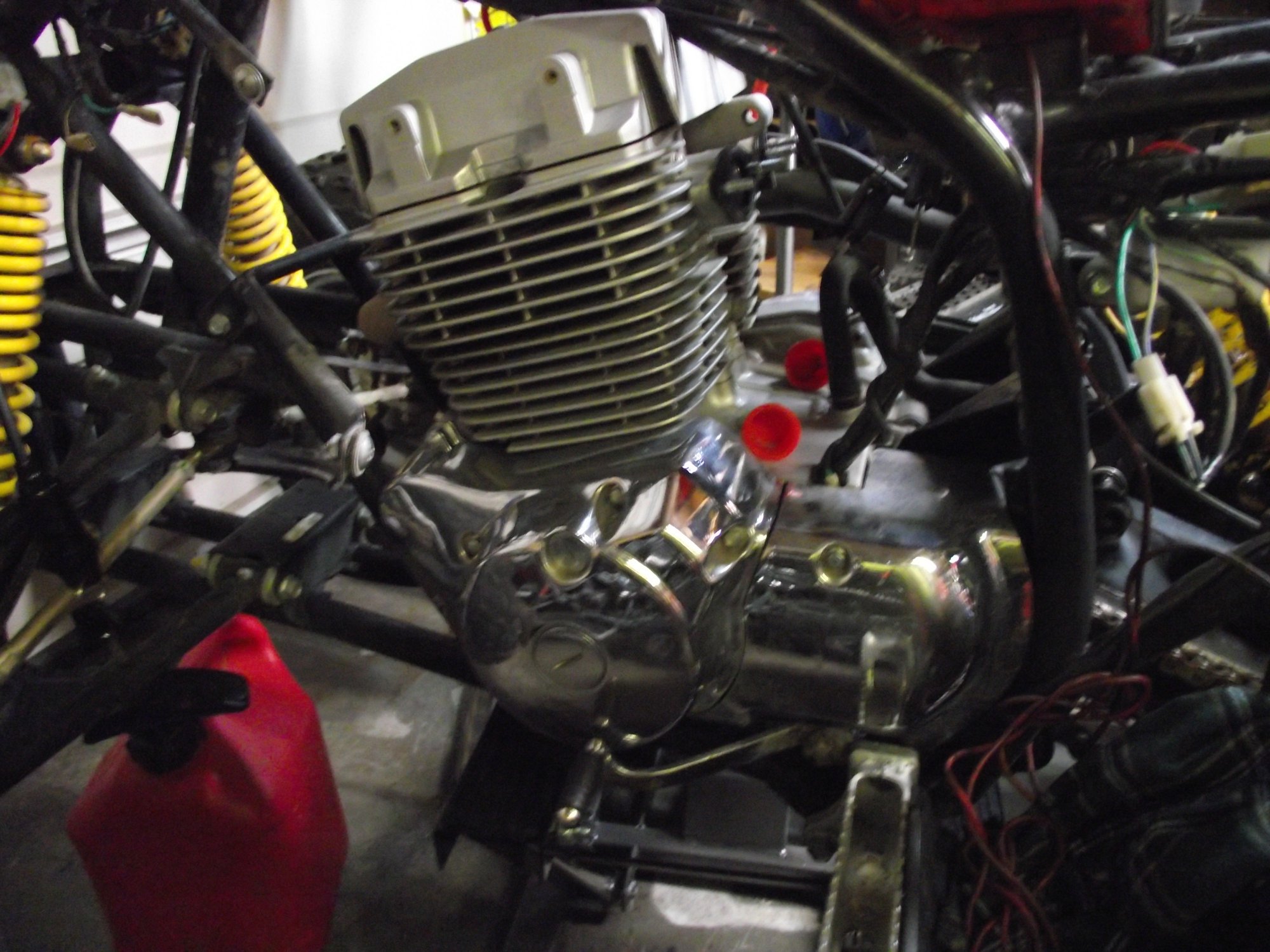

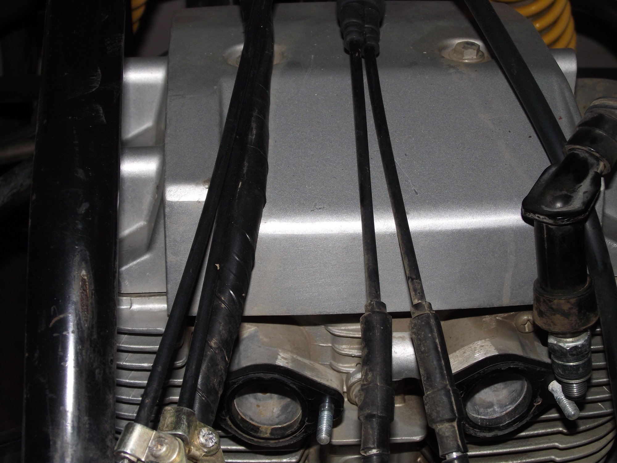

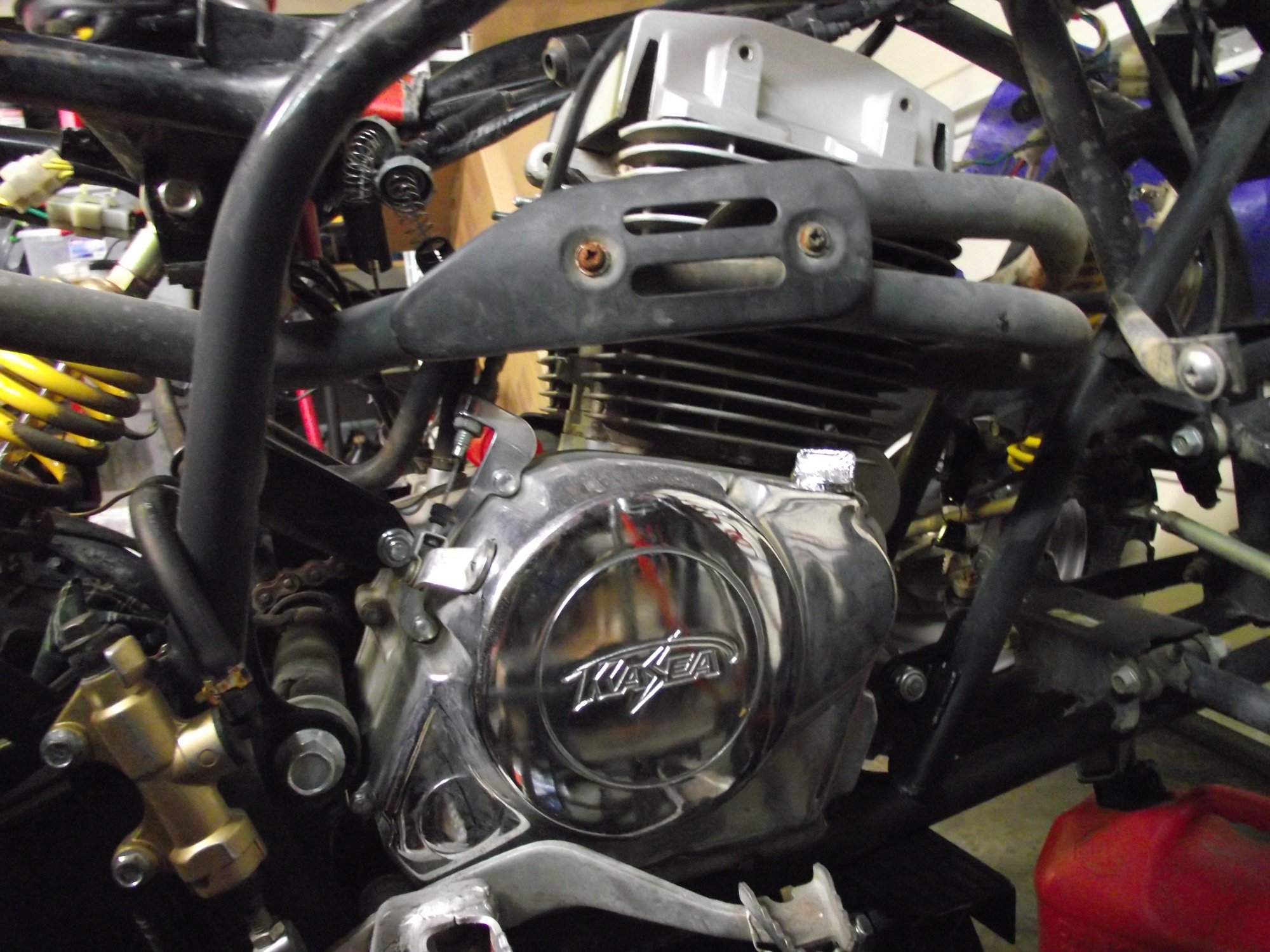

Thanks but this atv came with a 2 carb setup and I'm going with one with a cross over pipe that I got it was so hard to try to get both carbs setup and was hard to get to one of them to adjust so that's why I'm going with one much easier to do.

Good to go. I would hate to have to troubleshoot 2 carbs at the same time. My 800cc Jetski has 3 carbs on it and I just leave it alone. I just run it once in awhile to keep the gas flowing thru it.
How is this set up with two carbs? Does it have two heads on it? Post some pics.
