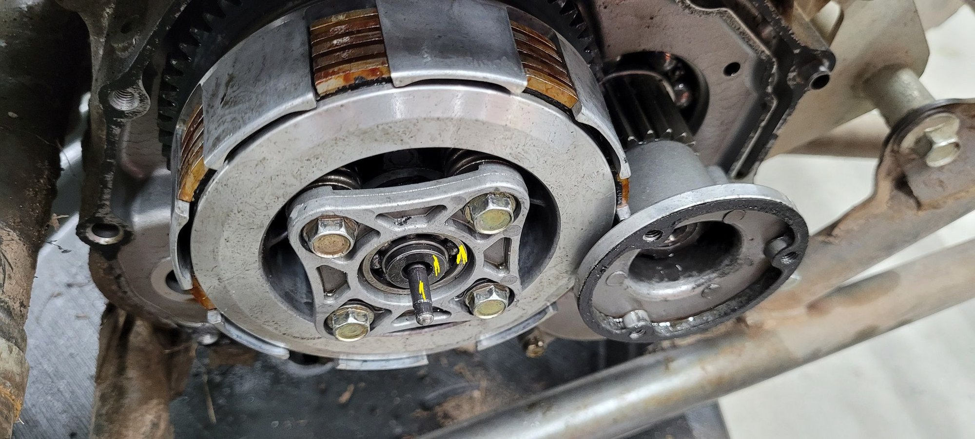

Hello all, my son was riding his atv and he broke the clutch cable. I purchased a new cable but quickly realized the Arm on the side of the engine will not budge at all. I took the side off and disassembled the whole clutch basket and put it together and I cannot figure out how this is supposed to work. The clutch lever pushes in on the Rod, but that whole plate is bottomed out on against the studs its screwed into, so it cannot compress the springs.
The rod, and everything I highlighted in yellow comes out easily without taking anything else apart in the pic, so its not like its pressing against the input shaft of the transmission which my thought would be to push up the clutch lifter to uncompress the springs. I don't understand the design of this or what is wrong. I checked this site and I have all the parts so nothing is missing in the diagram https://www.adlyparts.com/atv-parts/...70-quad-clutch
