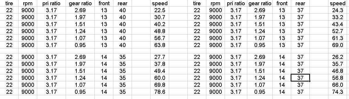

Here's a speed chart for the warrior:
Let me know what changes you want to make to the chart.
