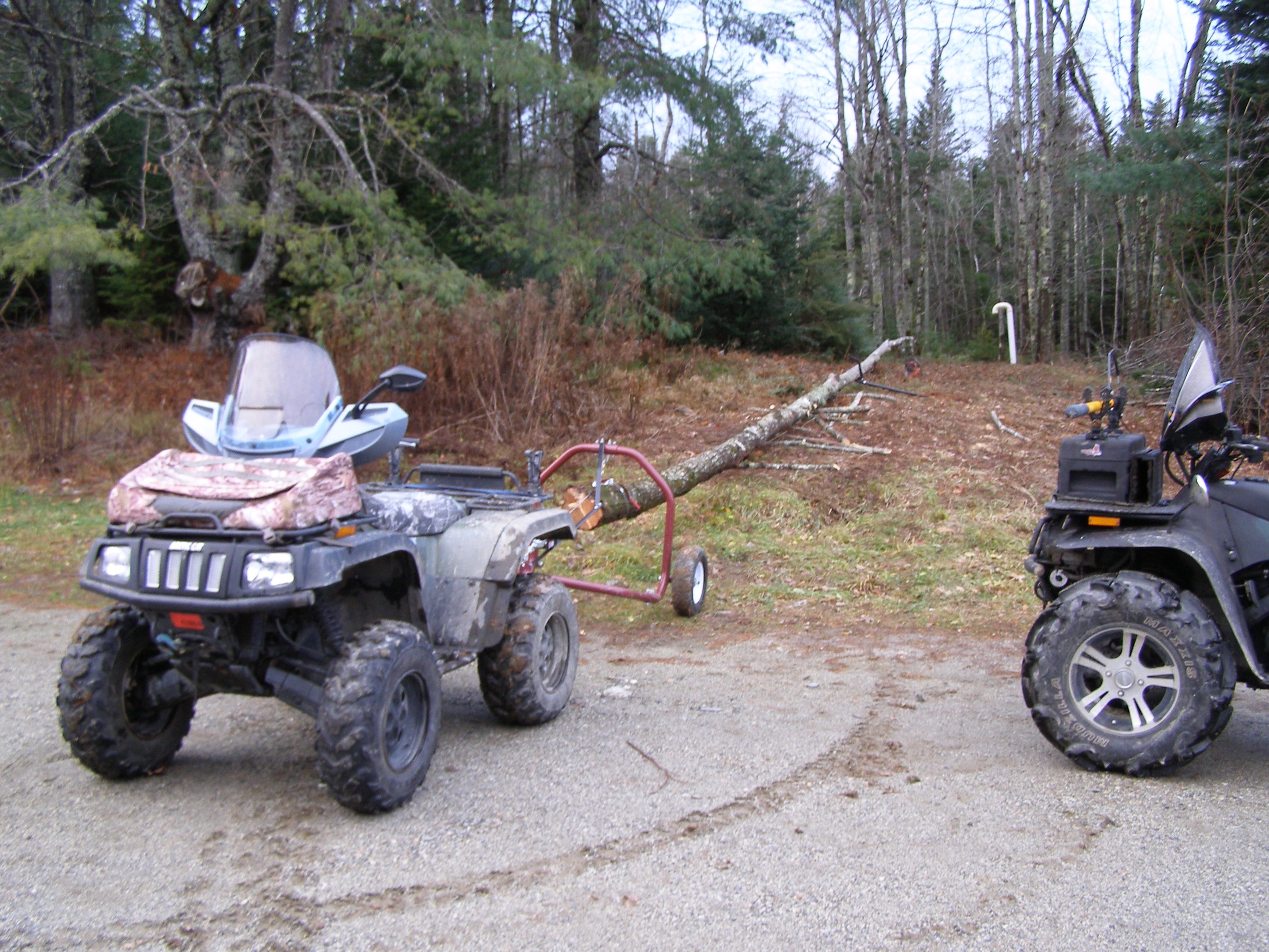

Hard to say, but, I would try to borrow one to try first, unless you plan to use it for other stuff. Of all the ATV's I've ever driven, that Arctic Cat diesel blows everything else out of the water. It has gobs of torque, it already weighs 900 lbs. 1 of the trails that I ride on, is probably that steep, I know a guy pitchpoled a Jeep going down it. Rode the wife on back of the diesel, it felt way safer than any other ATV that I've taken down. It's the only one I'd trust to take the wife up and not flip, as it has a low center of gravity and a long wheel base. It will also depend on what kind of surface, the trail that I spoke of has sharp rocks and gravel, like ball bearings, bad for traction. I think even a farm tractor would not be safe for your application, big risk of flipping! So if you are hauling the weight downhill, you might think of retrofitting electric trailer brakes to the trailer. A trailer going down hill can push you pretty hard. Here's a picture of my 2002 Arctic Cat 400 that I bought for $1,400. With good tires it would do that, but I'd still try to put brakes on the trailer. Here it's hooked to a log arch, it pulls very strong.
