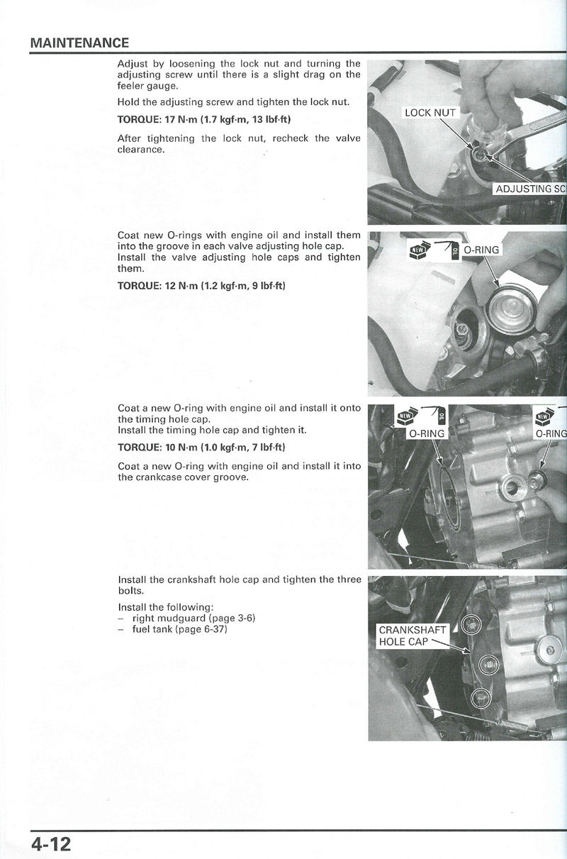

I have run out of time to buy the shop manual and i really need to do this before i go on my trip this weekend. if anyone can scan just those pages from the shop manual you would be a live saver!

Pages 4-11 & 4-12 in the maintenance section of the manual cover this procedure.
See page 4-11 here and page 4-12 here.
Let me know how it goes. With just 14 hours on mine I haven't done this yet.

you are a life saver! or at least a valve saver!
