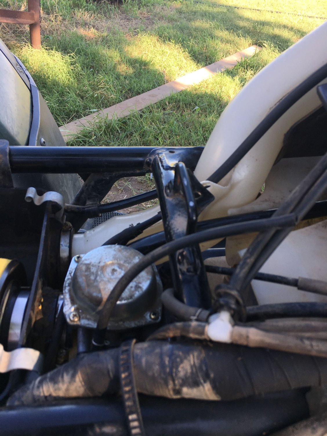

I think i captured the mixture screw, and the throttle ****. Where does the vacuum/vent? orifice connect to? Adjoining picture shows another vacuum/vent hose not connected to anything.
Where does the hose that comes out on right side. going up and ending on left side of pic.
