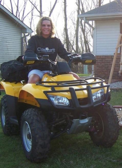

Here is my wife's 07 Recon ES. No problems so far. I would buy another one in a heartbeat!
