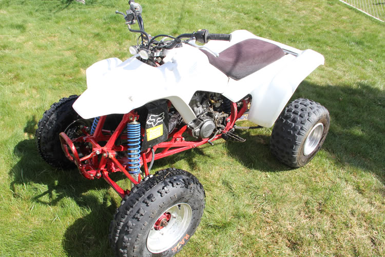

Here's a photo of it just for the sake pf posting a picture.
