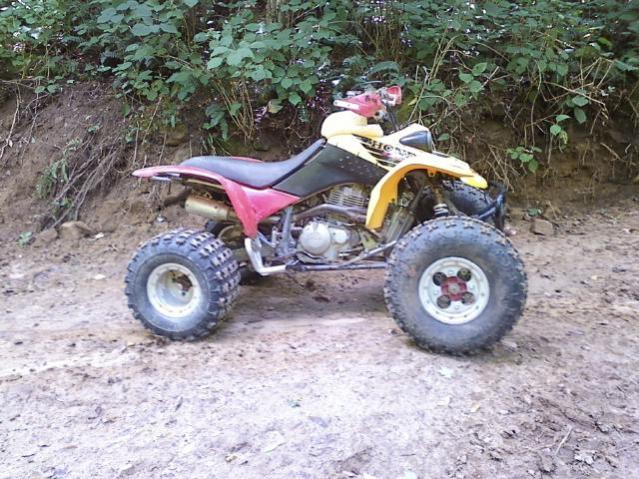

If your quad looks like this:
Then 20's for the rear seems to be a good choice for the riding you've described.
A 10" rim is pretty uncommen though, i'd just use the 9x8 rims with a 20x10x9 tire (or 20x11x9).
23's or 22's would be pretty balloon looking for the front...
Heres what you would expect with 20's on the rear and 22's or 23's on the front.
I'd say if your quad is a sport quad just stick with 20's for the rear and 21's for the front (For your riding conditions at least). Bigger tires on sport bikes don't look that great in my opinion.
