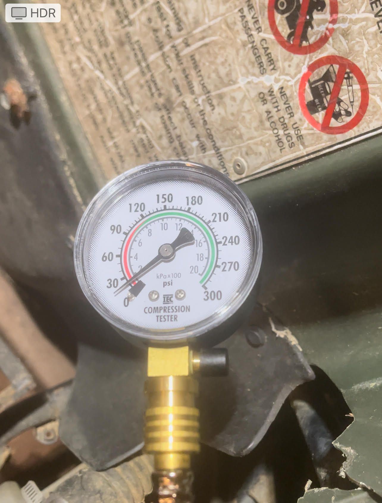

papa hogg scoot... ive done the compression this morning after returning the other tester and getting one that has 12mm adapter for plug thread size... i took video of it but it wont let me post it saying the file is to large.. its only 12 secs long. non the less... the compression guage jumps to 15 on about 2nd revolution and stays there. i let the engine prolly turn over about 5-6 turns. Thoughts? as best ive read.. the compression should be in the 100-120 range?
Old May 20, 2024 | 06:45 PM
papa hogg scoot's Avatar
Loved
Community Favorite
Joined: Jun 2010
Posts: 1,709
Likes: 30
From: Notheast Alabama
Yeah it has a issue there do you have any history on this atv? was it running before you got? did it quit? did it backfire then died?
